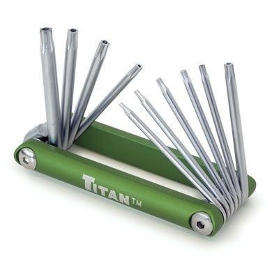

do you have hand tools.. small metric stuff to get into the various panels around.. 7, 8, 10MM  sockets and nut drivers..  some torx...
AZ Tamperprooftorxtoolsku12710 Zpsc1647dd2
