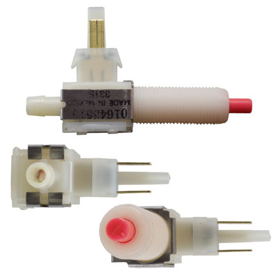

21 25524844 * SWITCH, S/LP (M.T. EXC CR/CONT)(1984-86)(ACDelco #D889) * 1
21 25524845 * SWITCH, S/LP (CR/CONT)(1984-86)(ACDelco #D850A) * 1
21 25524848 * SWITCH, S/LP (A.T. EXC CR/CONT)(1984-86)(ACDelco #D851A) * 1
22 1645516 * VALVE, CR/CONT VAC & TRANS CONV REL(ACDelco #212-346) * 1
24 10075405 * RETAINER, CR/CONT VAC REL VLV (1984-85) * 1
24 22534155 * RETAINER, S/LP SW(ACDelco #22534155)
the switch item #22... delco 212-346 is shown for both the brake and clutch pedal  on manual transmission cars..
Ac212346 1
this is an SW3028 at autozone or from wells
plunger depressed.. contacts closed..
plunger extended.. contacts open...  vents when plunger is extended.. pedal depressed..
the vacuum section of these switches is shown at the lower right corner of the diagram..
the electrical portion of these switches is shown at the above left corner of the diagram..
if these switches are NOT available... take them out.. on a big towel.. you can disassemble them carefully..   the contacts inside are silver and you MIGHT be able to burnish them with the tip of a screwdriver to restore contact continuity..
