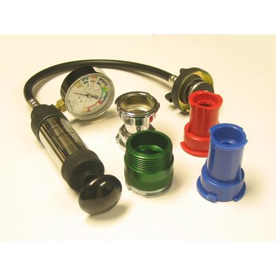

hi my 70 small block vet heats up and there is no pressure in the rad or hoses is this good or bad thanks

does the system hold water?????
you might want to first change the radiator cap..   they have been known to NOT hold pressure as some of them have the small disc in the center of the rubber seal that is NOT spring loaded in the upwards position.. it just dangles waiting for coolant to push it closed.. a great idea.. except.. it does not always work..
do you have a radiator pressure tester???     some parts stores have these in the Loan a tools section behind the parts counter.. where you pay for the loaner tool.. and can return it for a refund within 2 weeks or so..
this is where to start at..    the pressure tester allows you to pressurize the system to 13 pounds pressure and let it sit to see if there are any leaks...

THANKS GUYS I HAVE A LAZER GUAGE AND READS 210 THE SAME AS THE GUAGE IN THE CAR.I RENTED A PREASER TESTER AND A NEW CAP AND SAW THE FLUID WAS DOWN A LITTLE. I WILL TEST OUT THE PREASER TESTER AND GET BACK TO YOU GUYS THANKS FOR YOUR HELP

I would fill the cooling system cold. So you don't have pressure drops because of temperature changes. Then with a coolant pressure tester put 16 psi on the system. The pressure shouldn't drop maybe 2 psi it at all.
