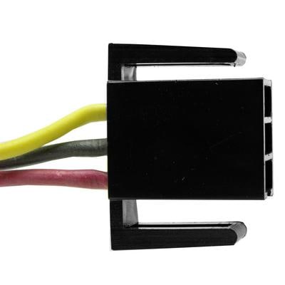

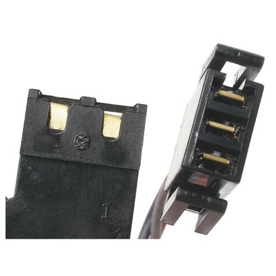

this is the module end of the connector shown on the distributer above...  U518
this is the connector that plugs into the cap...
notice the black wire..  that connects to the brass terminal with the screw through it as shown just above..

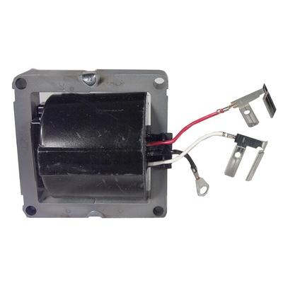

this is the in the cap HEI coil...
notice the black wire with the ring terminal. this should be on the same screw that the hooked end of the ground strap is on..
this grounds not just the ignition coil.
it is the SPARK return path...
yes...  the high voltage spark that runs down the wires and across the spark plug gap has to go somewhere to create a complete circuit...   spark plug gap..  heads.. intake.. distributer hold down clamp, distributer housing..   the screw holding the condenser bracket. the black wire to the cap. the ground strap.. through the laminations.. if not painted..  to the black wire on the ring terminal into the coil to create a complete circuit..
