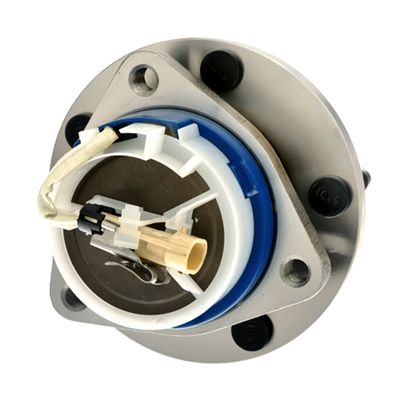

you could also be loosing a wheel bearing and hub assembly..   as that is more likely to straighten up during turns..
this is what the back side of a hub and bearing assembly looks like for the front...
big wide tires exert additional loads on these and a good pot hole can hammer the ball bearings and dent the races causing failure..   sometimes a car will get into deep water usually when parked so the owner may never know..   the water will leak into the wheel bearings and cause corrosion and bearing failure..    these are NOT that hard to change on the fronts.. the rears just a little harder as you have to loosen the axle nut to get them off along with the mounting bolts and ABS sensor wiring..
the change in vibration when turning really indicates wheel bearing failure..
jack up one wheel at a time.. see how much up and down movement you get at the tire.. in and out at the top and bottom..

usually with the later model ABS brakes...  you have to remove or unlatch the rear stuff as shown above on the front wheel hub.. to remove it...
you do have to remove the wheel.. unbolt the caliper from its bracket...  move it out of the way and hang it on a thick wire to prevent the brake hose from being stretched ...   pull the rotor..    then the bolts probably come through the back...
hubs vary in price...   depending on the brand and where you buy them...     you are probably going to want delco or timken brand

Just some FYI Anytime your around those ABS sensors be careful not to bang or even hit that wheel hub, I've seen guys install wheels with an impact and a customer is back complaining brake light is on.
