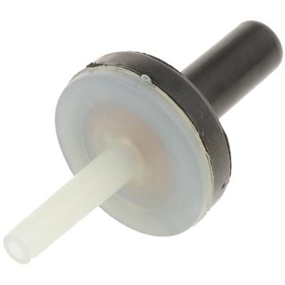

since i don't have a C3 to examine first hand...  as i mostly do a few C4 models..  a three pronged check valve is currently available in many parts stores..
this is a dorman 47150 vacuum check valve..  usually found out in the isles of the parts stores in the HELP section on a HELP card..
this is a 47149 vacuum check valve.. few stores are going to have this.. but they are available..
the hose sizes are probably wrong for what you are replacing.. as i recall the metal check valve used by gm had 1/4" fittings on both side.. but i could be wrong..     i am not telling you to install the WRONG part on your corvette.. i am trying to help solve your issue until you can get the proper part..  test your check valve..
